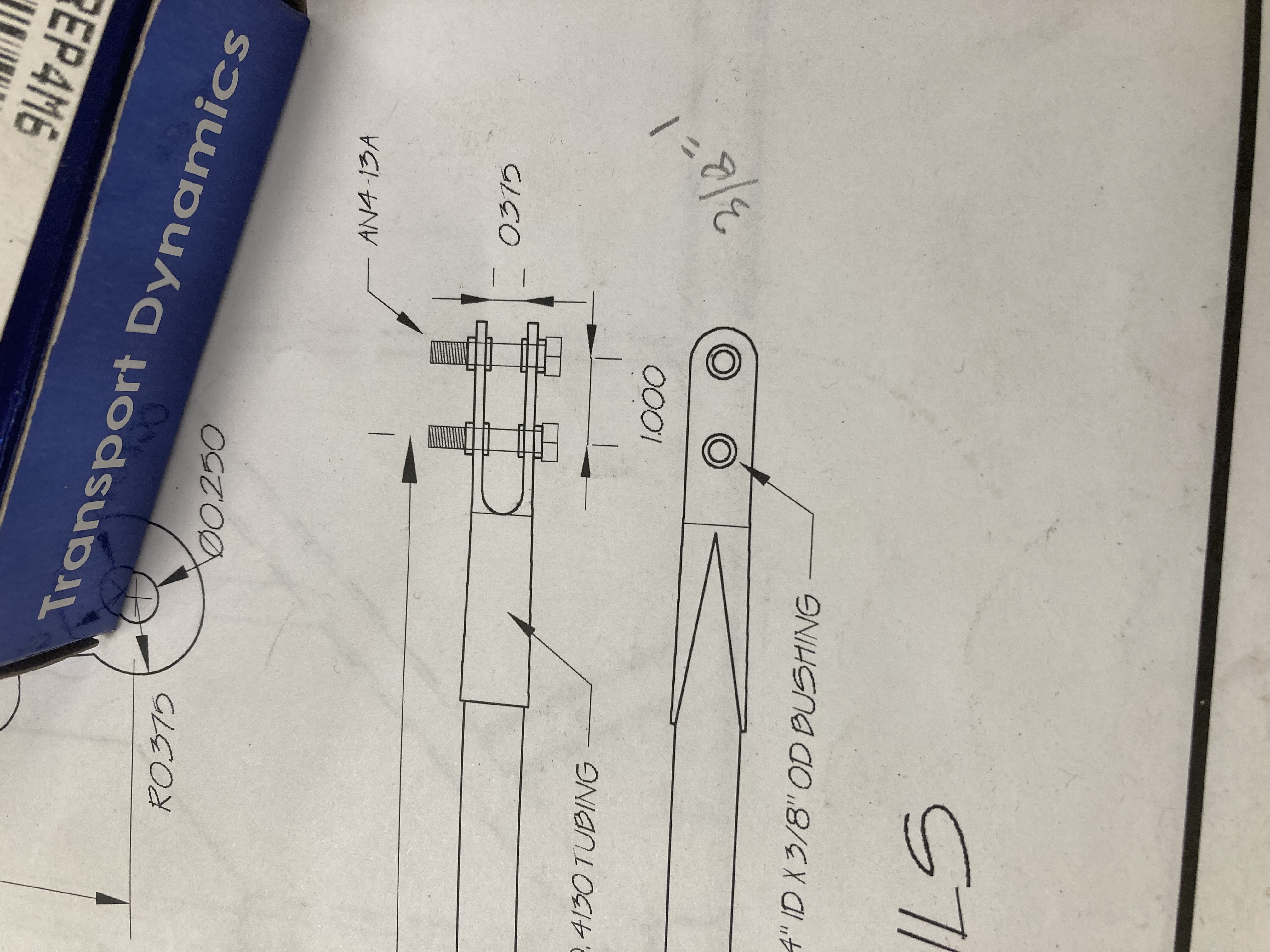

Curious what others have done. The plans call for a piece of 3/4" sq tubing to be affixed to the end of a piece of 3/4" round tube. That presents a sort of round peg, square hole scenerio.
My question is, why can't it be something along the lines of what the plans for the Acrosport show. I really so no apparent reason it couldn't be. Am I missing something?
