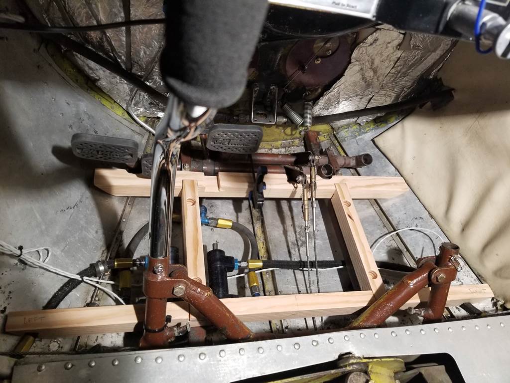

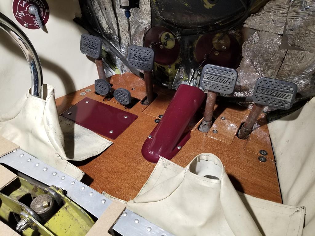

Making the stick removable is probably easy enough. The stick and rudder pedals in my '48 Luscombe are removable. The pilot side has bolts holding them but the passenger side just has clevis pins and quick release pins.
The floor boards were a mess so I replaced them with some mahogany I bought for my Hatz floor. I flew most of the year without the passenger controls. Lots of passengers don't care to fly the plane and it gives them more room.

Passenger quick release controls
New floor boards
New floor boards
