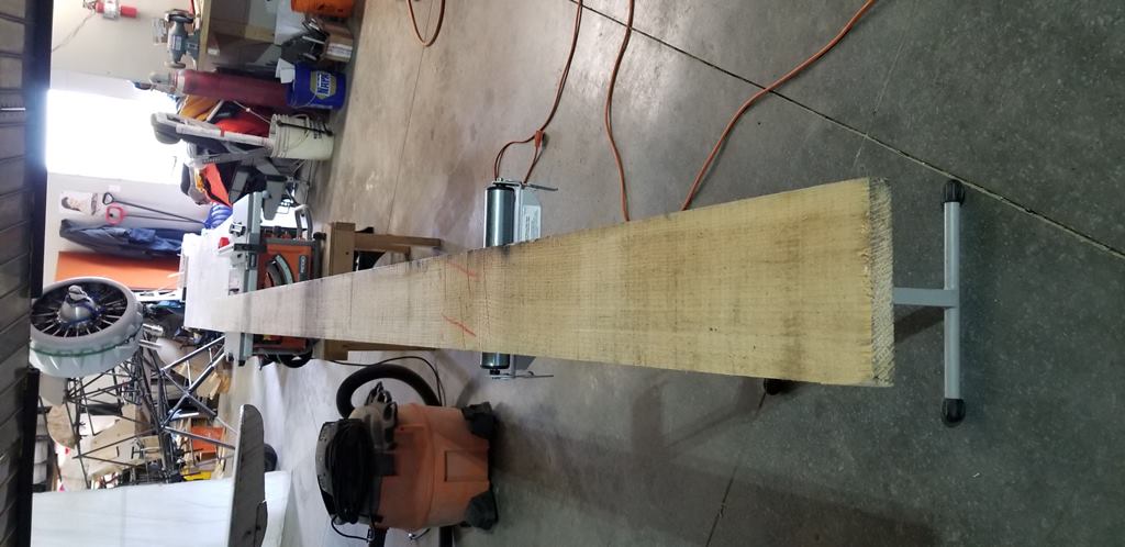

I know they have quarter cut Sitka spruce locally. A 14' 1x6 would be nice. No splicing.
Re: Stringers

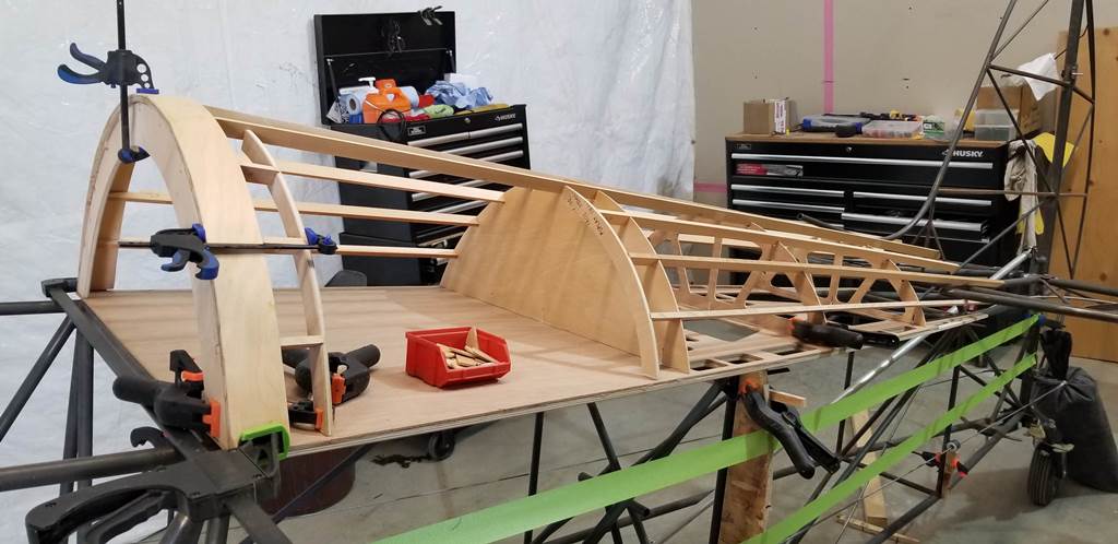

I ended up using the leftover tops of my spars for stringers for my Turtledeck that I made of wood. I bought a 14' 1x6 Sitha Spruce board locally for my side stringers. It's slightly less $ than capstrip from A/S and I don't have to have them shipped or splice them.
