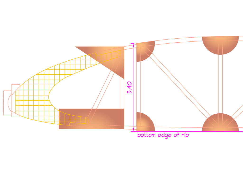

Since every build is unique, here is a good way to figure out the centre section spar:
Place a straight edge along the bottom of one of your ribs. Measure the distance along the edge of the spar from the straight edge to the top of the rib and subtract the thickness of your fuel tank material and the 1/4 " for the plywood along the bottom. The 1/4" plywood at the bottom is assumed to be straight and blended to match wing so it is straight when assembled.

Could I place the spars in place on the bottom ply, place a finished wing rib against them with the bottom of the rib on the table , Mark the spars from the rib then subtract the tank thickness?
Re: starting center section
That will work. Just remember the ribs have a 1/16" relief at the top of the spar for the plywood leading edge. So you will have to add the 1/16" then subtract the tank thickness.
