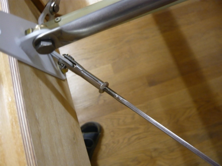

We think there is no news that we make available our 1/8" light weight tie rods with rolled UNF 10-32 left- and righthand rolled threads. The material used is a AISI 316L stainless steel which meets easily the specs (min. 2100 lbs), what means that they are able to carry the same loads as Bruntons AN 703 round drawn tie rods. A set of 24 pcs. at 40" (AN665 clevis pin to pin) weights almost 3 pounds less that a set comprising of full 3/16" round wire with cut 10-32 threads. We made our own such tie rods for our Vintage Hatz (Classic) and would like to provide this service for others as well.
By coincidence we found an old ad in a 1929 Aero Digest magazine by the then Steward Hartshorn firm (New York), who manufactured just then what we have released nowadays.... See pictures and ad included.
Please ask for a quotation at hans.u@aeroplaneworks.ch. We can make lenghts up to 50" by the way.

I received my Drag / Anti Drag wires from Hans and Sam a few weeks ago and could not be happier with them. The quality is excellent as are the threads on the ends. I had made up some temporary wires to use during assembly and I could not have created anything this nice. It will be a shame to close them up in the wing but a surprise for the next lucky owner who goes to recover her. Long after I am gone I hope.
Thanks Hans and Sam, now at least part of my Hatz looks as nice as yours. :D
