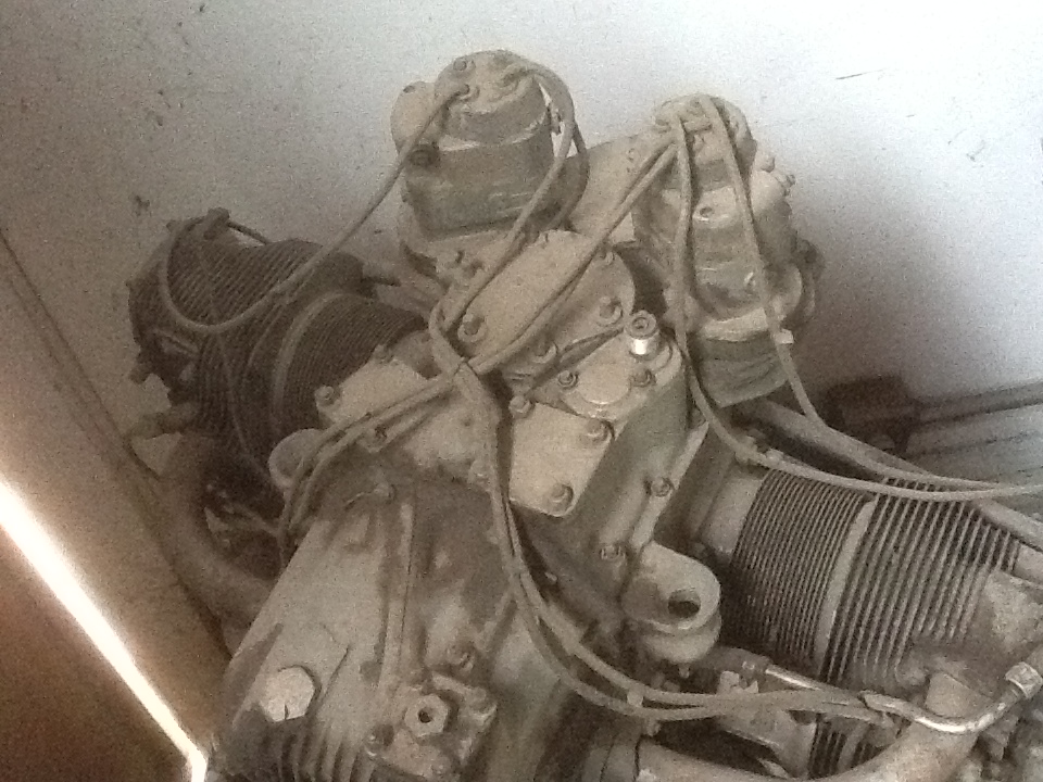

I have an early O235 on a stand at the shop that has the same accessory case configuration as the -3. I'll take a picture of it later today so you can see the difference.

Re: 0-290-C formally a "-3"
Dave,
Here's that picture of the accessory section of a "-3" engine. The big plate in the center is where the starter mounts.
