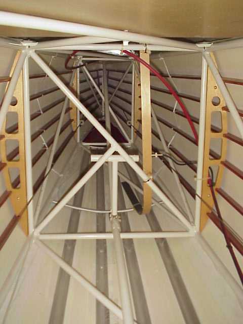

I came across this thread while I was doing the research on stringers. I also found this picture on the Hatz Classic CD. It looks like the builder interlaces tape the same as for ribs in the wing. Just another solution to keeping the stringers straight for covering.
