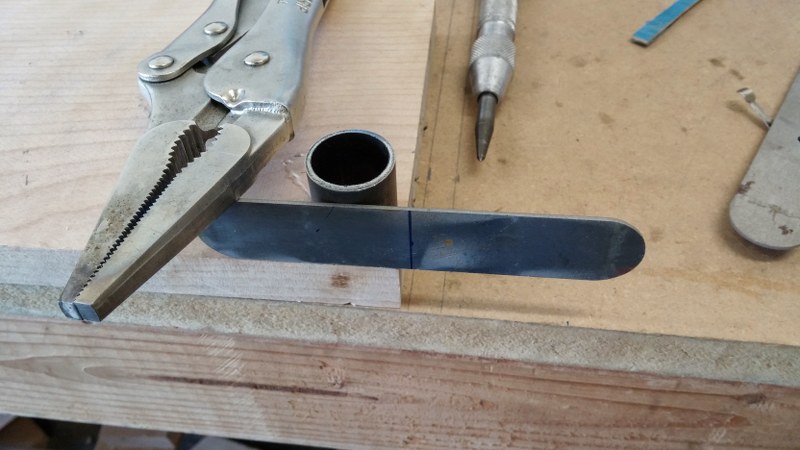

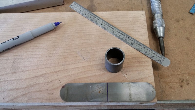

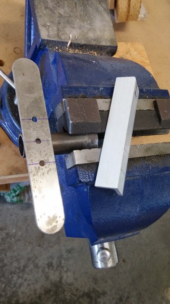

Step one: Have the strip that wraps around the short tube section that becomes the hinge and the hinge tube section cut to size. Better leave the strip a bit longer at this stage. Mark the center of the strip:

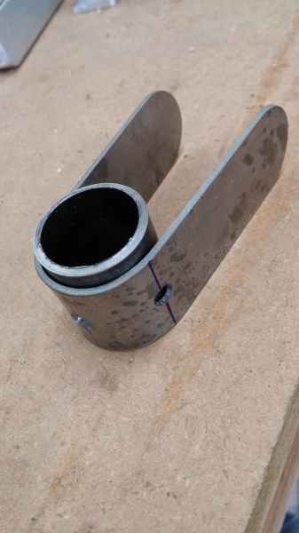

Step two: We need to find the place for drilling the other two holes in the strip for the rosette weld. I placed the tube near a 90° corner, and then rotated the strip from center-over-tube, 90° to one side. This gave me the location for a hole (repeat for other side):

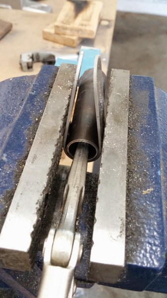

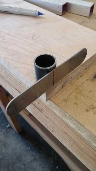

Step three: With the holes drilled on the marks, place the strip perpendicular to a 3/4 tube we will use as a bending radius. In hindsight something slightly larger would have been better, perhaps 13/16", because the strip will be actually welded to a 7/8" short piece of tubing.
The angle piece is used to find the perpendicularity between the tube and the strip.

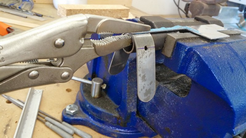

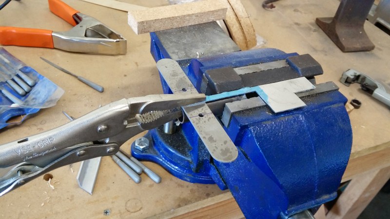

Step four: Now a little elbow grease is applied:
Step five: Due to the spring back, finish the bend in the vise:
The result:
