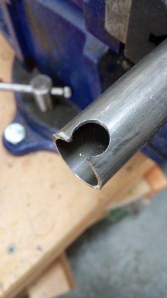

first, drill the leading edge to accept the trailing edge, but only on one side of the tube. In other words, don't drill all the way through.
Then chop the leading edge at the end of the hole you just drilled, like so:
preparation
preparation

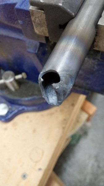

Then, using the torch to heat and a flat head hammer to move metal, "fold" the ends inwards:
folding in
folding in

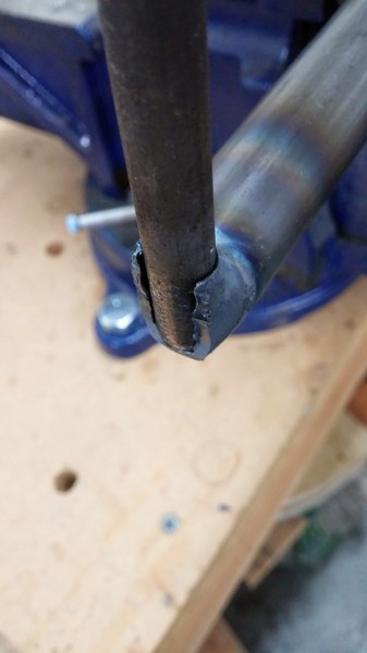

Check for fit (you might need to use the bench grinder to get the edges nice:
check for fit
check for fit

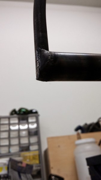

Special care should be taken so that the opposite edge of the smaller diameter does not flare outwards. Again, I used the hammer and heat:
no flare
no flare

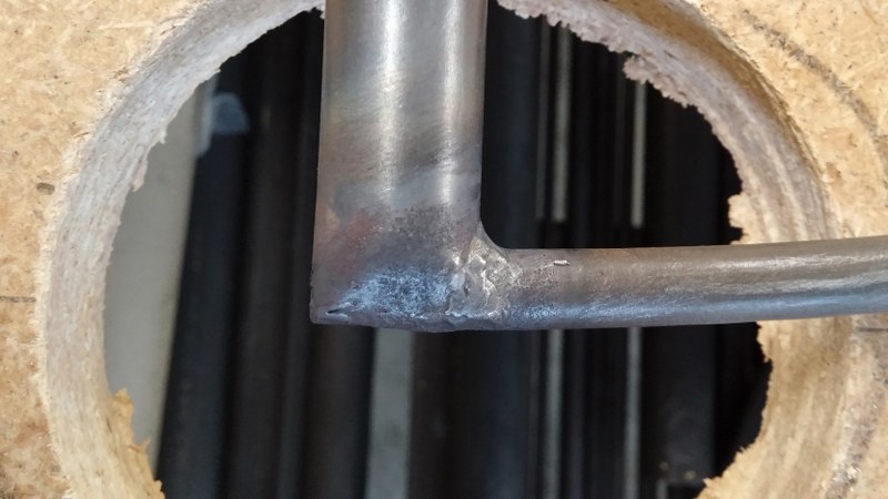

The end result after welding:
welded
welded
