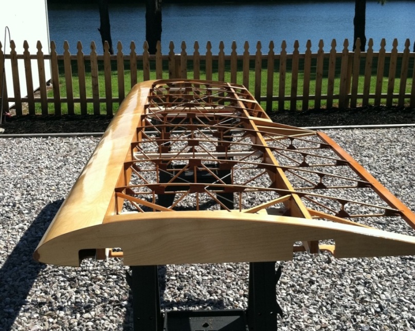

I used 1/16" x 2" wide nailing strips tacked parrallel to the leading edge at the center of the nose ribs and false ribs along with the very leading edge molding. I used 1" x 1" strips that I clamped the leading edge skin down with at the spar and clamped it about every 6" or so. After the epoxy had cured I filled the tiny left over nail holes that were barely visible with Bond Aide. It worked perfect as long as I made very accurate measurements to locate the nose ribs and false ribs. I used 3/8 brass aircraft nails mainly because they are so small in diameter and left such a small hole after removal. Removal was accomplished by breaking away the thin plywood leaving the nail exposed to pull out with duck bill pliers. Hope this helps some and if I can help just send me a email and I can give you additional infor on how I did it.
Top wings complete resized.jpg (248.45 KiB) Viewed 6092 times
