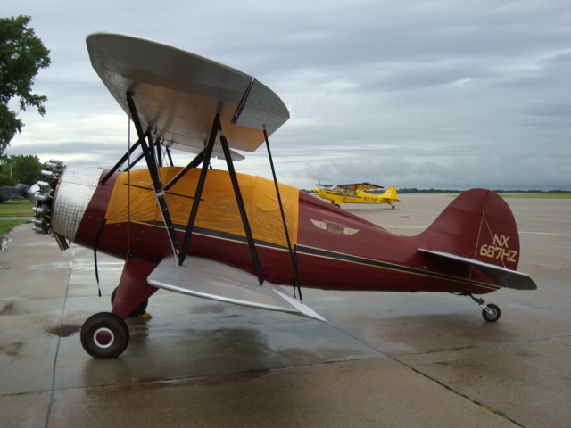

As a temporary (semi-permanent) solution i used an old rain fly from a two-man back packing tent cut to fit. The sewn-in peak of one end of the fly fit nicely over the front windshield and there was enough stretch in the material to not require resewing. Allowance for the cabanes was reinforced and the aft end was cut to fit about 12" behind the rear pit. The whole thing was held in place with 1" webbing and plastic backpack clips that lay flat.
It wouldn't hold up under a Sun & Fun tornedo but I doubt that anything would. It kept the rain out of the interior successfully each of the two days of torrential rain experienced going and coming to OSH. Hope you can find a better color than shown in the picture attached.
Ground in Mitchell SD on return from OSH
