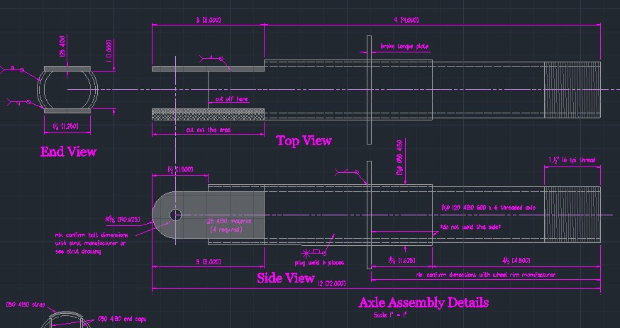

Where did you get your axels from?

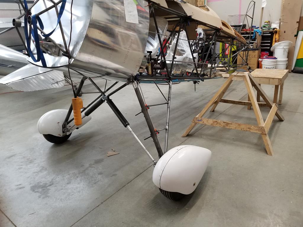

Re: Main wheel size recommendations
1930s style tall thin wheels would look pretty nice...
6.00x6 on my CB-1, though.
beechdrvr wrote:Where did you get your axels from?
They came with the couple of projects I bought, but they are A/S Homebuilders Main Weld-on 600 X 6 Axle. I also bought the spring struts. They are for cubs but custom made to length to fit my gear no extra charge. I modified the axle connection from the Classic plans to fit the spring struts. The rod end wouldn't fit in the axles as shown on the plans.
