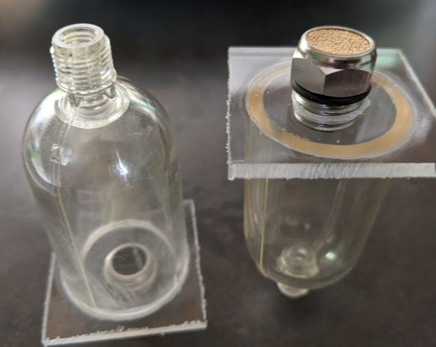

I only used the bottom clear bowl. The trick is to get the ones with a 1/8" NPT fitting on the bottom. You can unscrew the pressure release valve at the bottom out.
I then cut the top 1" of the bowl off, to get rid of the odd size thread.

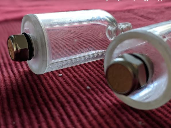

Ordered a 1/8" thick Lexan sheet, cut to size and drilled and tapped for a plug that is also a breather vent. Drilling with a step-bit was easy.
super-glue, sand to look nice.

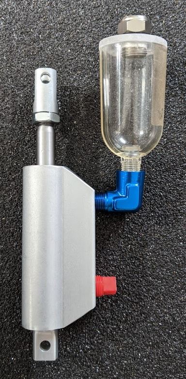

And here it is with the master cylinder
I will test with brake fluid before I commit to this, to make sure the plastics are good with the fluid, but I am optimistic.

What brand of master cylinder is that?
Re: Easy pre-filght brake fluid reservoir
jwhanson wrote:What brand of master cylinder is that?
Matco:
http://www.matcomfg.com/MASTERCYLINDERS ... 265-5.html
