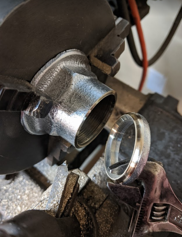

On the outside though, I looked for a 1-1/2-16 thread nut and could not find one that was not outrageously expensive. Van's Aircraft used to carry these for the RV-10, but they changed the design.
Thanks to Al Gore I have the internet ( :lol: ) so I found that Kohler used to make a plumbing part with the right thread. Searched and found that TEAM Pipe & Supply in Illinois had a couple of the 33881 parts (in chrome!) for about $35 each.
Got them, took off the end that has a different thread on it:
Kohler 33881 mod.PNG (1.01 MiB) Viewed 5255 times
And voila, an airplane part courtesy of Kohler plumbing.
I still need to drill 1/8" holes for the pin that goes through the slot in the axle.
