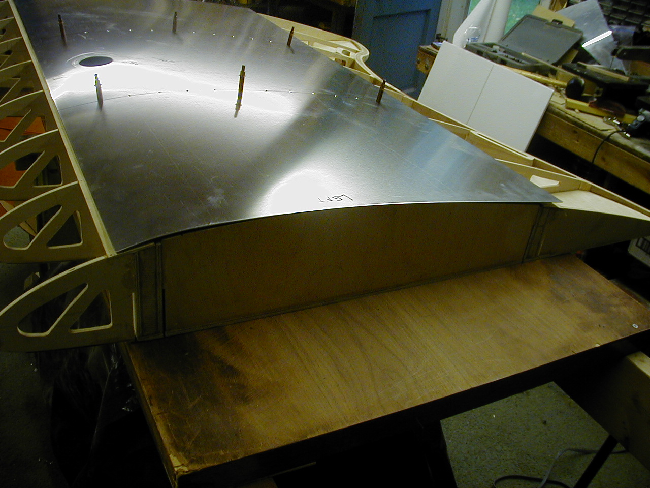

Fuel Tank 10.08.05-6.JPG (344.19 KiB) Viewed 4779 times
Hi All,
I sold the tank that came with the project I acquired and built one similar to what the Classic uses. The top of the tank is the top of the center section. I calculated that it will hold 25 gallons which I thought was better when using a 0-320. I found out why the Classic uses a 3/32 thickness for the top when mine (1/16") warped and puckered. I wound up riveting the top on with pro-seal (still 1/16").
