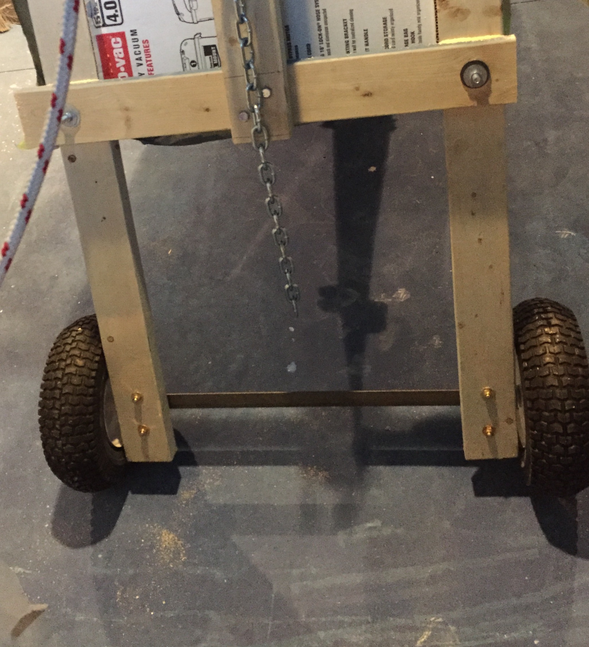

I'm pretty pumped at this stage of the build. All major components are fabricated covered and painted. My next step is to move the fuselage into the garage for firewall forward. As we have rough winters in the NY snow belt I need to keep the project and vehicles in the garage. I have temporary gear on for the move and plan on installing the permanent gear as soon as it's in the garage. For planning purposes, what is the standard wheelbase on the Classic?
Stair climbing gear.
As always, thanks.
