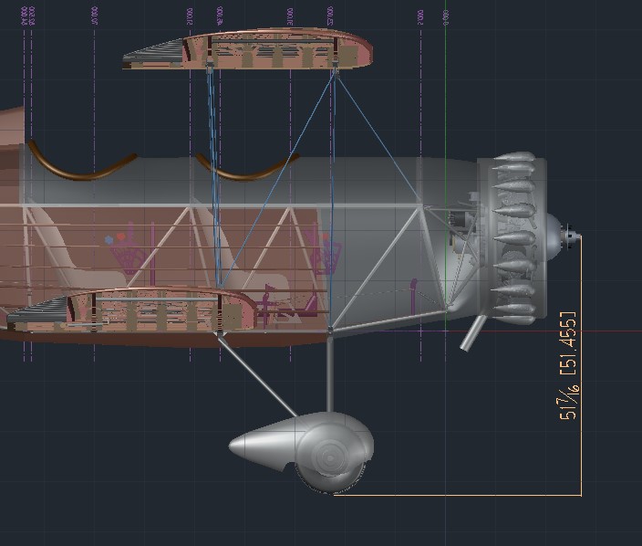

I'm mounting the Rotec R3600. I just used the regular gear. If I use the recommended 84" propeller I should have 9" clerance.
Screenshot 2024-11-23 194725.jpg (63.76 KiB) Viewed 20237 times

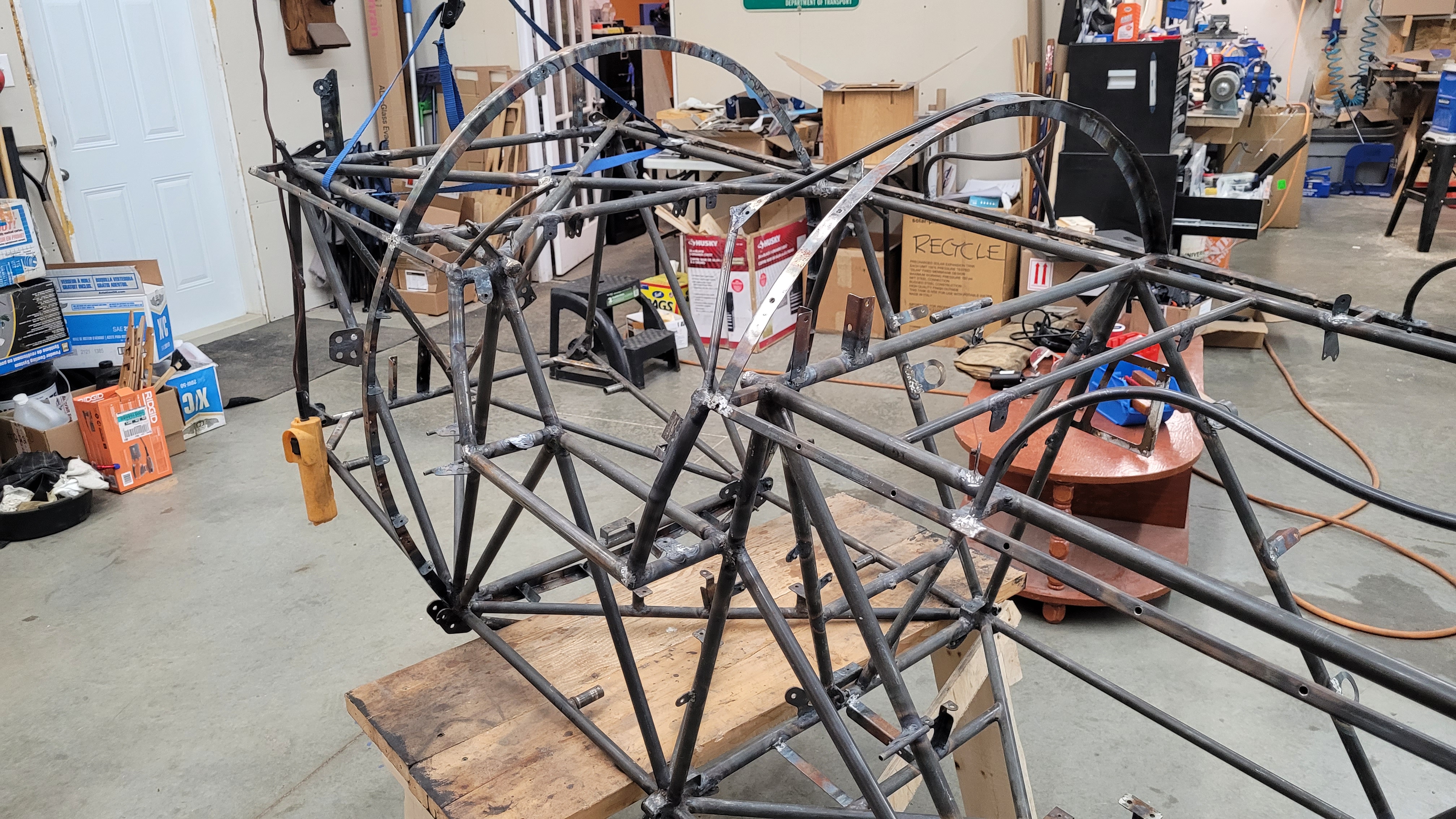

When making the front door, did you cut and lower the top longeron? And if so what tubing structure did you use.
Thanks,
Jim
Re: Alterations to the Classic plans on the "Vintage Hatz"
I did cut out the upper longeron. I based the location of the new sill on the second stringer from the top. It's just above the throttle linkage. I used 3/4 035 to build the new sill and frame around the door. The outside matches the shape of the stringers. I added a couple of cross members from the lower frame to the sill. I used 1/2 035 for the door frame itself. I got the idea from Mark Taylor. He sent me some pictures of his. You can see my structure in the picture below.
I have a blog about it here: http://myhatz.blogspot.com/2024/05/2024 ... -more.html
