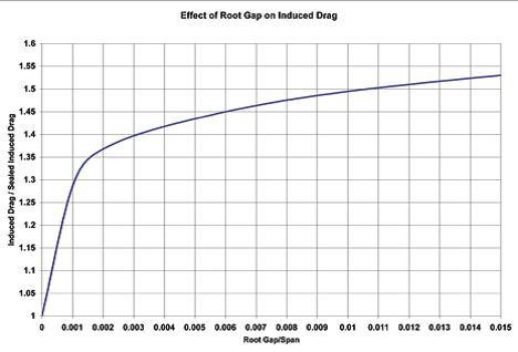

Figure 1 shows the theoretical effect of a single gap in the center of a rectangular wing. It illustrates the induced drag of the wing with the gap open divided by the induced drag of the wing without the gap as a function of the ratio of the rootgap span to the wingspan.
Note how quickly the drag rises with the gap size. A gap that is one tenth of a percent of the span increases the induced drag 28%. That is equivalent to a quarter-inch gap on a 25-foot span airplane. Remember that the plot is for a single gap, but a real-world airplane has two wingroots.
The effect of the two gaps is made worse by the fact that they are separated by the span of the fuselage, so they are cutting the wing into three segments rather than two. Accordingly, for a given wingroot gap, using twice the gap of a single junction when reading the plot in Figure 1 will give a slightly optimistic first-order idea of how much induced drag penalty the gap will produce.
For our 25-foot span airplane, having a quarter-inch gap at each root is roughly equivalent to a half-inch single gap, and we can expect a 35% increase in induced drag. At best rate of climb airspeed, the represents an increase of 26% in the total drag of the airplane. Because climb is a function of excess power rather than total drag, a given percentage increase in drag will reduce the rate of climb by a larger percentage than the percentage increase in drag.
For our example, the two quarter-inch wingroot gaps will likely reduce the best rate of climb by somewhere between 30% and 40%. It may be even worse than that, however, because the analysis just presented does not take into account the parasite drag penalty of the air flowing through the gap, or the flow separation it may cause.
The important thing to remember is that a relatively small air leak near the root of a wing can have a startlingly large detrimental effect on the climb performance of the airplane.

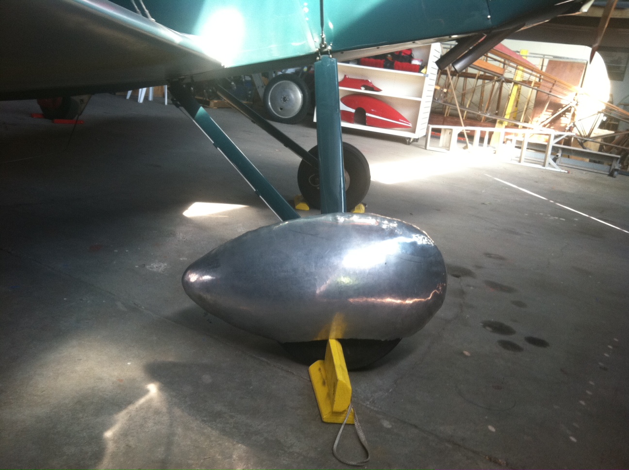

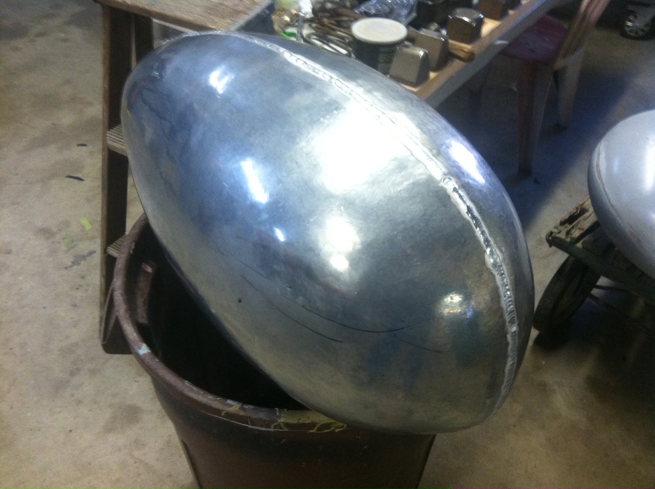

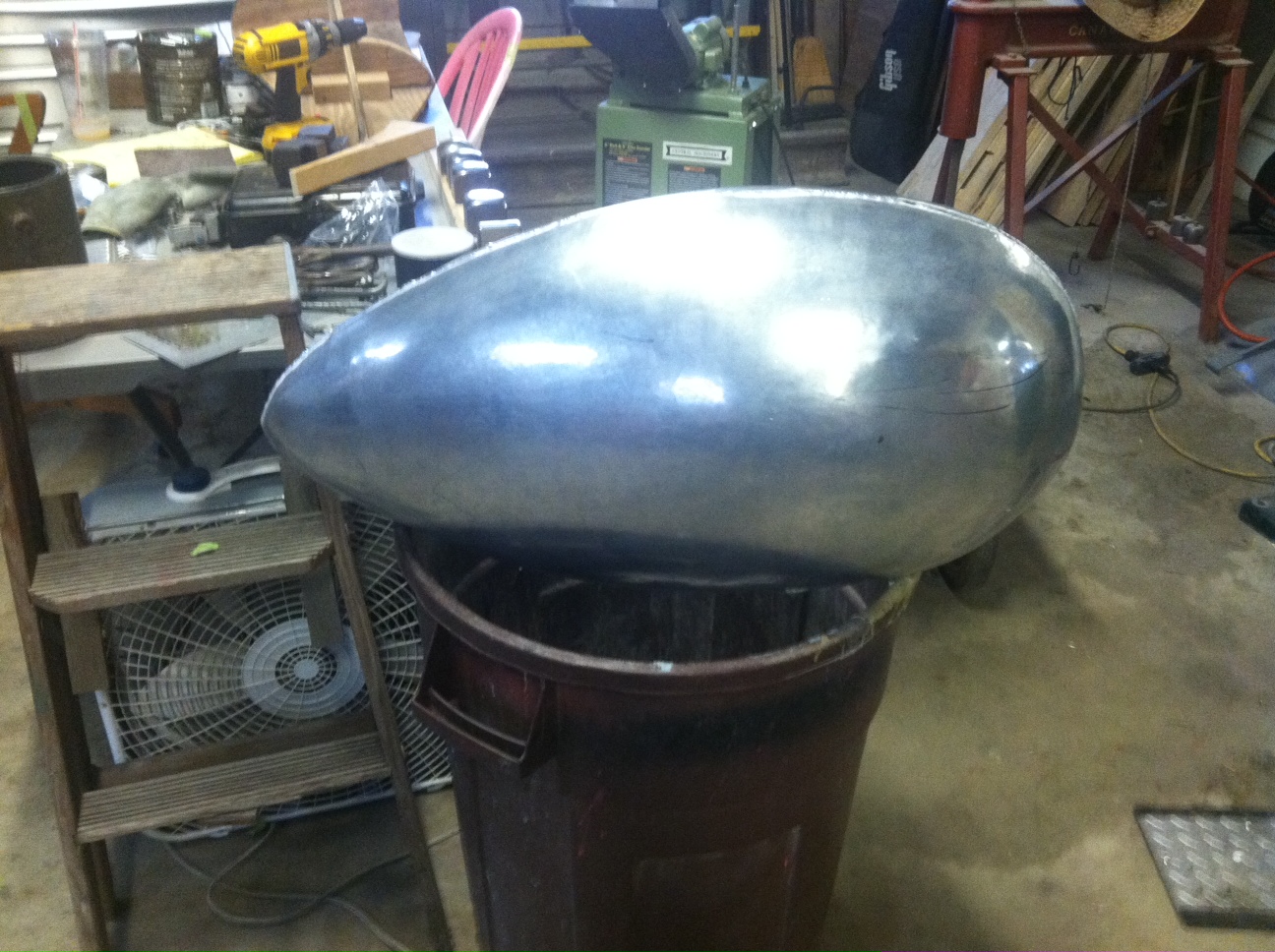

Here are some progress pics on the wheel pants I'm making.
These things are a LOT of work!!!! Fun though.....
