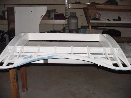

Another center section
- Center Section 1 painted.JPG (20.71 KiB) Viewed 6148 times

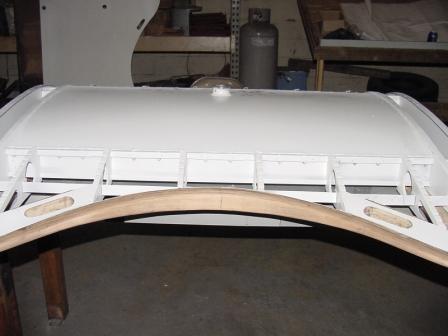

Re: Aluminum spar wings
Another Center Section
- Center section.JPG (18.3 KiB) Viewed 6148 times
- Posts: 154
Sorry Lorin. I just caught what you were talking about. You are right. The small holes were an after the fact add. I added them more for strength than weight.
