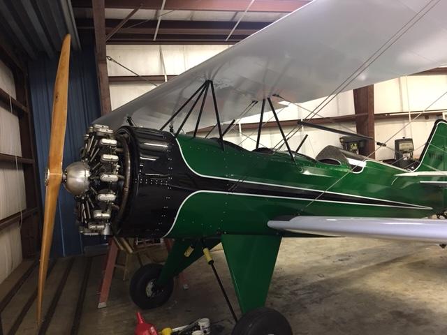

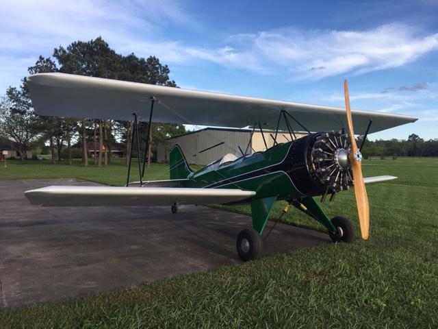

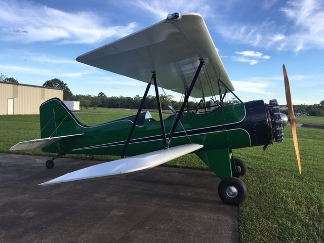

Trying again to upload a few pictures of the Kelly D.
- Posts: 204
Re: Finishing a Kelly D started by my brother
Wow! The Rotec looks perfect on the Hatz, that is the first one I have seen on a Kelly D. Great job, really nice lines and beautiful paint. I love the way the fuselage fits with the engine, that is always a challenge and yours looks great.
