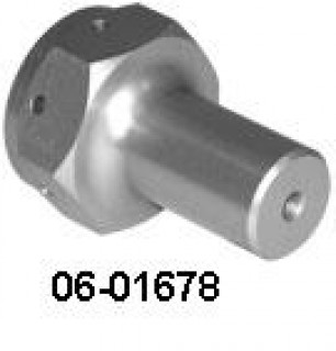

Thanks Jeff. The spacer would solve the problem and allow for a change of wheel size/type. I have another set of wheels that have a 3.75" spacing for the bearings that would fit the 4.5" long axle. I'm thinking a regular castle nut won't work though as there is nothing to hold the cotter pin. I did find this on ACS (part# 11726). The hole is in the nut instead of the axle.

That's the axle nut that I am using. I am installing it with un-threaded end against the wheel so that I don't need a spacer.
Re: Wheel recommendation?
That clinches it. I'll order that nut.

My wheel setup are Grove 6x6 hubs/dual piston calipers, 1-1/2 weld-on axles,grove wheel pant axle nuts(06-01678 acs) all bought from aircraft spruce.
Hope this is some use. I also made 1/8in thick spacers for nut clearance/wheel hub.
Steve(HC0162)

Now there's a good idea if the plane has wheel pants. I was thinking I would have to weld something onto the wheel nut.
