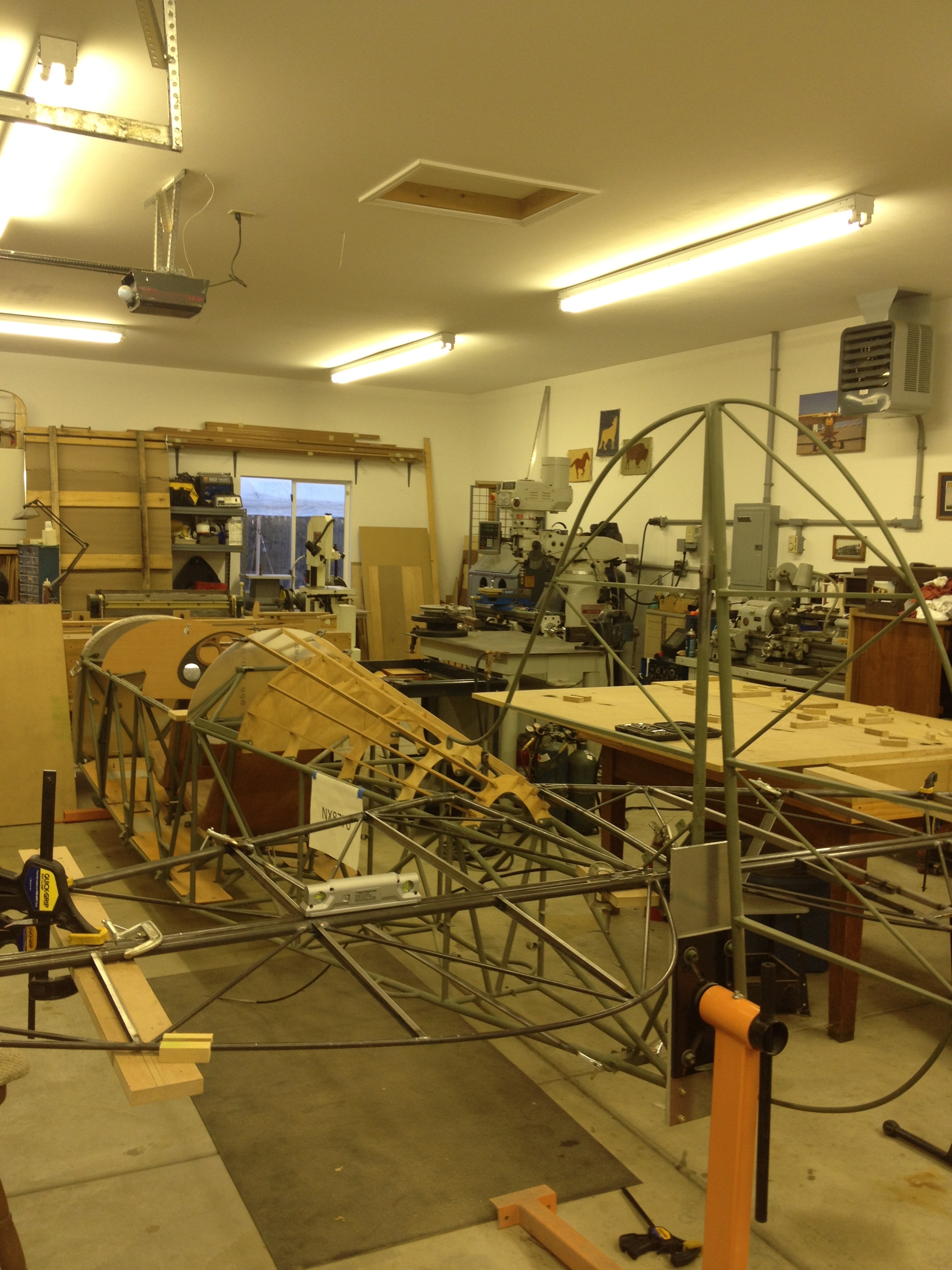

As I was laying out the elevators for my CB-1 I noticed something interesting on the plans that I had not noticed before. The shape of the elevator is not quite the same in the 3 view drawings on the front of the plans compared with the detailed drawing later in the plans. As I contemplated this, I was able to find an inflight picture of Happiness, John Hatz' original airplane, taken from above and behind, and I was also able to look carefully at the elevator shape of the second Hatz built, Dudley Kelly's airplane, that is for sale right now on Barnstormers with photos. The elevators of Happiness, John's original airplane, seem to be continuously rounded on the trailling edges, appearing to match the 3 view drawing, while the elevator shape of Dudley's airplane seems to match the detailed drawing on the inside of the plans, more of a straight line trailing edge with a larger radius at the outboard end. I am wondering if Dudley modified the shape of the elevators for some reason when he drew the plans. Just wondering if anyone else had noticed this, or had any information or thoughts about the two shapes... I think I like the rounded 3 view shape a little better. The area seems about the same. Thanks, Paul

I wouldn't doubt Dudley tried to simplify a few things for the average home builder. Good catch on that, I had never noticed.

I think what happened was that when Dudley was drawing up the plans he was just relied on some photos, rough drawings and phones call. My Dad used an old Taylorcraft tail on Happiness and I would assume he told Dudley that, but he probably didn't tell him he reshaped the elevators. Dudley probably just assumed the elevator was shaped like a Taylorcraft also. It just aesthetics, make it the way you want it.

Thank you Al. What a pleasure and privilege hearing from you. I appreciate your thoughtfulness in answering. My tail is rounded now, like the 3 view on the cover of the plans. I like it. Paul Uhlig
